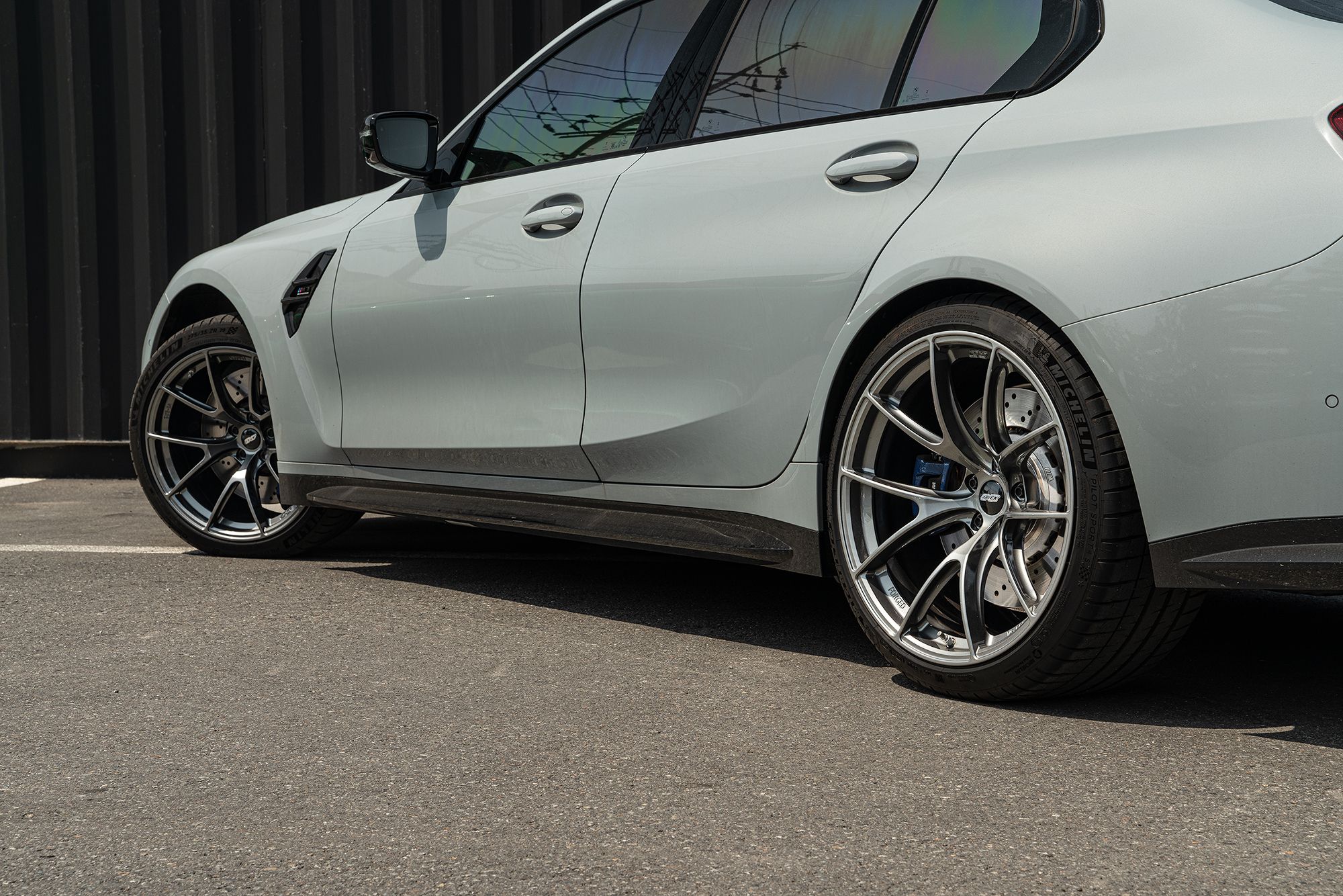

Heres an example of how that stock tire setup looks on a G80 with the 285 on the 11. Definitely a bit of stretch but not that bad to my eye:
Full gallery available here: https://apexwheels.com/gallery/bmw/m...nthracite-1511
-Tom
