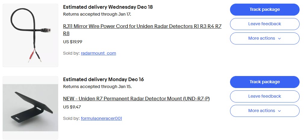

Location: MA
I am getting an R7 for christmas, grabbed the following mount and power:
Similar thoughts to Wilco, will put next to the mirror as under would be far too low even if it was right up against the bottom.
2025 M240i Xdrive TNM
~~Build Thread~~

I got the ebay wire kit today, has 2 sets of pins.
Will report back on which kit I use.

Location: MA
Originally Posted by WilcoJunoHotel View Post
May be just the zoomed in picture but boy even those small pins look too big for the BMW plug.
I got the other kit you linked and the pins are smaller and actually square profile, the pins on the ebay one are the same thickness but are wide and flat.
Of the two kits, the ebay kit is better made and highe quality, but all that matters is which one works!
