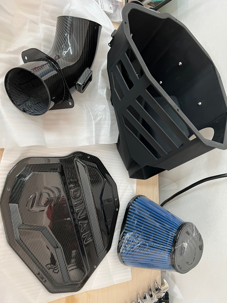

2022 M240i X-drive
Miles: 7,500
Mods: None
Just installed this product as my first "performance" mod. Install was smooth and had no issues. Parts are solid quality and as to be expected from Dinan. I know this is more of a noise-maker and the performance gains are very minimal. That being said there was definitely some placebo effect from the enhanced noises. Throttle feels a bit more responsive?
One thing I'm confused about is the sound when I let off the gas. I realize there's no BOV but the sound it makes almost sounds like it's getting bogged down. Anyone else experience this?
Worth the $500? There's nothing else for the car at the moment lol so if you're bored by all means. Hopefully suspension parts and tuning becomes available soon.

Confirmed the noise when you let off the throttle is excess boost out of the waste gate.

Mechanic opened the hood today to perform state inspection and found the carbon lid to the air box just floating around in the engine bay not attached to anything.
It appears the little plastic push pins used to mount the lid to the air box all broke or wiggled out of the holes. Will reach out to Dinan regarding this issue.
Anyone else have this issue?

Yeah running the intake open shouldn't be an issue. It is a little annoying that the plastic hardware fasteners they provide with a $500 kit is junk.
The bottom fastener of the plastic pin is too small and goes straight through the holes on the carbon lid. This prevents the top pin from penetrating the bottom pin far enough to make a secure connection.

Update: Reached out to Dinan and couldn't be happier with their response. They sent me a new carbon cover via overnight shipping. The new cover has slightly smaller holes which allows for the pins to securely fasten.

Is the air filter dry or oiled?

It doesn’t say anywhere on dinans site but I’ve had oiled filters before an I’m 99% sure this is a dry filter. I felt no oil residue on it.
Just to add that our intact tract does not have a MAF like previous gen b58s to get all messed up from over oiled filters. We now have a temp sensor instead of a maf.
