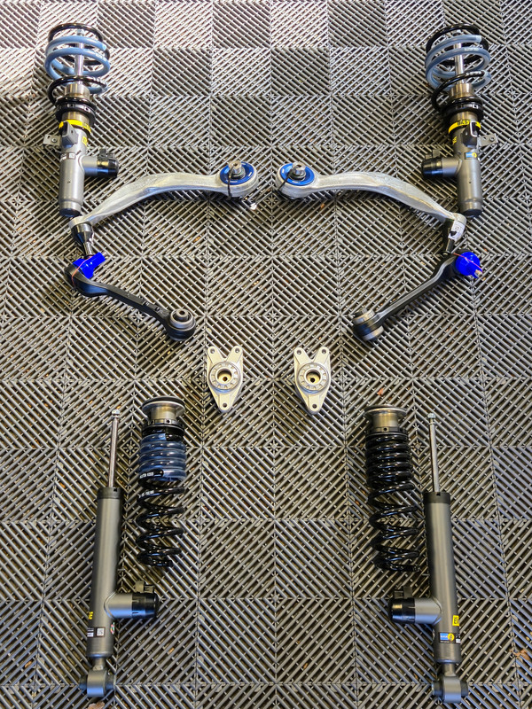

Suspension plan:
I started out with the Dinan lowering springs and bump stops. While I am happy with the ride height, and overall performance I decided that I would like to go further with the suspension and do a full revamp. On Saturday I discovered that that shop that I used to install my springs didn't replace any of the hardware that was used for the install. My strut mount bolts on the front right weren't tight on 2/4 bolts. These bolts are torque to yield and if properly installed cannot be loose. I'm now in a position where I can't trust the suspension as currently set because there are a number of torque to yield and one time use parts that I know were likely not replaced. As I had already planned to do full front control arm upgrades, I had about half the hardware to remedy this issue in my possession already.
Main parts to install:
Bilstein Evo SE Coilovers - https://cart.bilsteinus.com/complete-kit-49-305135.html
Turner Monoball Front Thrust Arms - https://www.turnermotorsport.com/p-2...nstalled-arms/
Hardrace front lower control arms - https://hardraceusa.com/products/fro...ries-g22-23-26
Hardware to be replaced:
Front
8x BMW Suspension Strut Assembly Bolt - BMW-07146884194
2x BMW Axle Bolt BMW-31206866022
2x BMW Suspension Control Arm Bolt BMW-31106885777
2x BMW Control Arm Bolt BMW-07119906460
2x BMW Suspension Control Arm Nut BMW-31106867397
2x Strut Mount Bolt 07146887408
4x BMW Hex Nut BMW-07119905307
4x BMW Combination Nut BMW-33306787062
4x BMW Control Arm Locking Nut BMW-33326760668
(Some extra nuts in there)
Rear
2x 33-50-6-889-267 Shock Mount - (BMW 3 series new rev mounts to fix OE rear clunk)
2x Cap - BMW (33-50-6-877-738)
2x BMW Control Arm Bolt BMW-33326762875
2x BMW Suspension Control Arm Bolt BMW-07119908024
I installed the coilovers and control arms for my car this weekend. The job required many tools and took me around 8 hours to complete when going very slow to ensure I did every step correctly.
All one time use hardware was replaced, and torqued to spec including marking each bolt for TTY angle tightening and noting the final positions.
With the Dinan springs I had significant noise over various road imperfections. The small imperfection clunk I was able to resolve by tightening my strut mount bolts, but another front suspension clunk remained prominent and unacceptable. While I can’t say for sure if the install was the problem or the springs, I made the decision to convert to coilovers and be done with clunk hunting.
I also installed the 3 series rear shock mounts that are used to resolve the rear end clunk. Of note, all of the OEM dampers on my 2025 car were Monroe brand dampers.
Post install impressions:
Suspension noise: All my suspension noises are gone, the car is completely silent over any and every type of road imperfection.
Suspension Performance: Overall the coilover system is stiffer. In comfort mode I would describe it as in between OEM comfort and sport mode, with significantly tighter body control. Sport mode is now “track” mode and while the coilover dampers retain good low-speed compliance the high-speed damping is firm. I will likely spend most of my time in sport individual with comfort suspension setting.
Steering Performance: The upgraded control arms really tightened up the steering response and added back steering feel that was missing in the OEM setup. I have not observed any additional NVH from the control arm upgrades. I suspect that if I added solid tie rod ends would also improve steering feel further but may significantly increase NVH.
Installation Notes:
I used the FCP Euro G20 suspension videos as my guide to complete this job. They are very complete and do a much better job of describing what to do than I ever could. I have made a playlist of the 3 videos you need linked below.
https://youtube.com/playlist?list=PL...pAhfF7FoTq8NeD
I suggest that anyone using these videos as a guide also makes a written guide for themselves from the videos. Be sure to note order of operations, bolt sizes and torque specs.
My tips from doing the job:
- I removed all four wheels from the car and prepped all four corners (removing fender liners, sensors, wire mounts etc.) before starting anything.
- Some sort of mobile tool cart would have been very nice to have and would have sped up my install
- You must have a full size ½” torque wrench with a flex head like this one: https://www.harborfreight.com/12-in-...nch-56470.html
- After releasing the axle bolt in the front, crack all of your high torque nuts and bolts before you remove anything.
- IMO, must have an electric ratchet to do this job easily. I used a Milwaukee insider ratchet and it was invaluable.
- A solid selection of sockets (short, long, integrated u-joint) is needed
- Removing the strut from the knuckle I used this tool, it was incredibly helpful compared to a normal knuckle spreader, especial ly in the aluminum knuckle https://www.amazon.com/gp/product/B0...?ie=UTF8&psc=1
- Also use WD-40 for the strut removal and re-assembly
- In the rear, a long 3/8” extension can be used to align and guide in the knuckle bolt during re-assembly. It’s nearly guaranteed that the bushing will not be aligned.

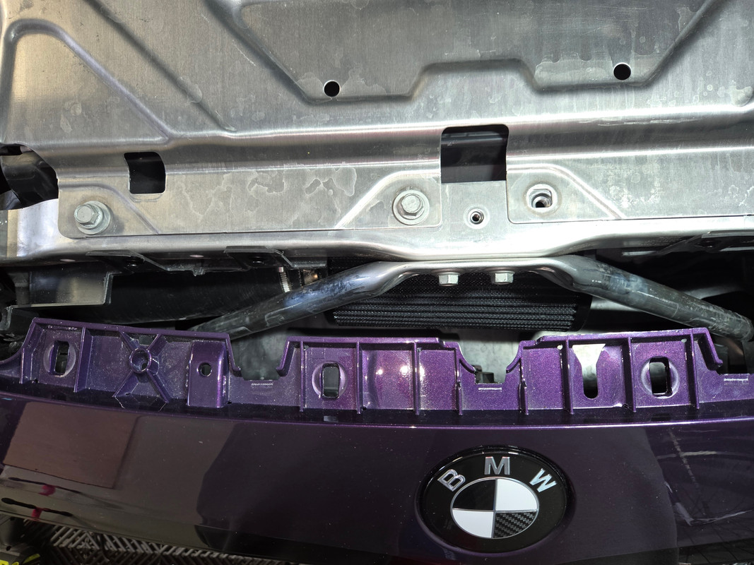

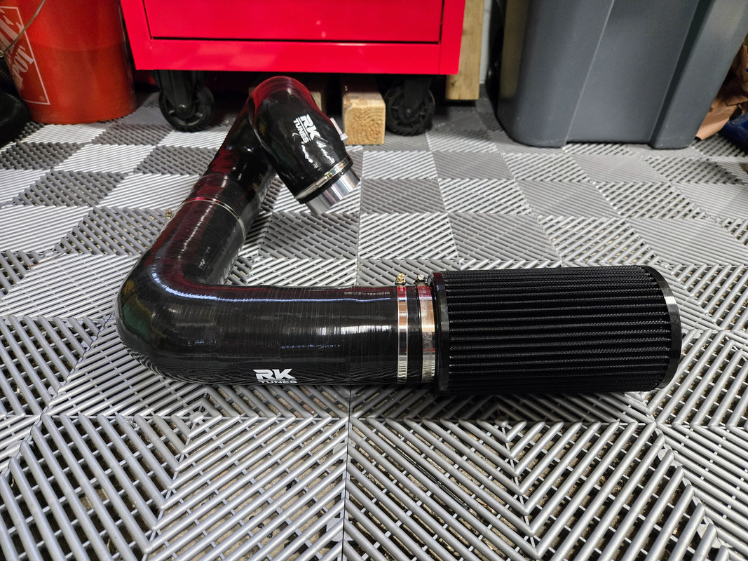

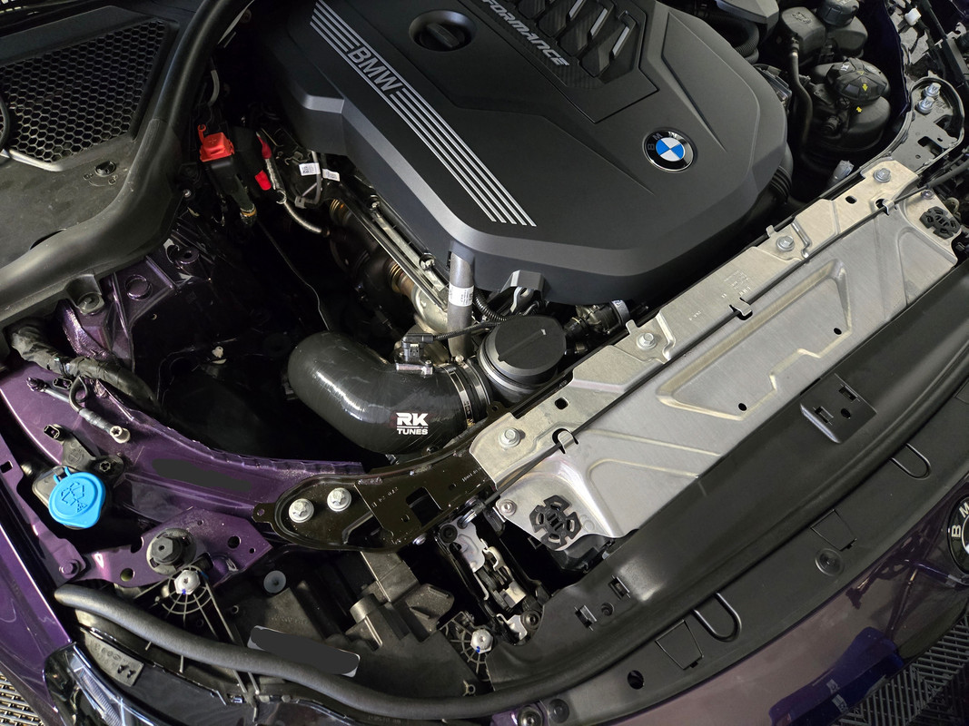

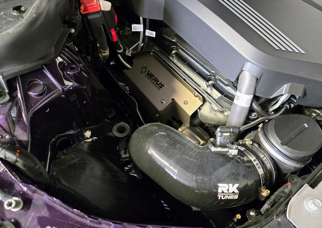

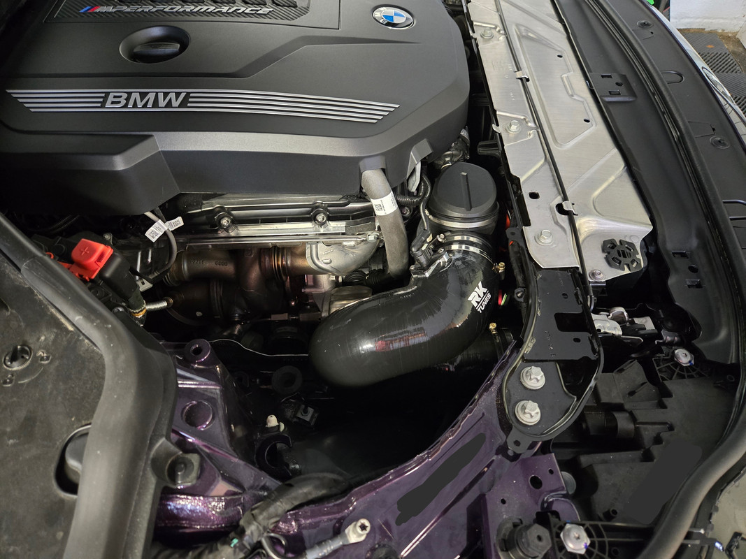

Installed RKtunes Front mount intake.
  • No bumpewr removal needed
  • Tight fit but works fine
  • Will be able to replace filter without removing any parts.
- Remove all the stuff on top of the radiator stack, including the silver cross brace that the Vbrace attaches to.
- Remove the active grill shutter motor for easier access to the area
- Remove OEM intake and snorkel. To remove the snorkel you have to break it down into its two pieces in place (tricky)
- Remove snow guard and trim the plastic/rubber shroud to make room for the intake tube
- Pass the 90deg elbow section into the front from the engine bay. Takes quite a bit of squishing and working and elbow grease.
- Attach all the pieces including the filter and get the intake fully in place so that you know the filter and front tube are in their final position.
- Re attach the silver cross brace without fully tightening the screws then the V brace, fully tightened.
- Install the cooling stack cover and squish everything together, its a tight fit.
- Reinstall everything you removed.
My install took about 2hours but mostly because I was being careful since I had no instructions on what to do.
Could probably replace the filter in 45 mins tops. I bought an extra filter to swap in so that I can clean the used one without needing it to re-assemble everything.
Added the Verus Heat Shield which you can read about here: https://www.verus-engineering.com/bl...sting-data-105

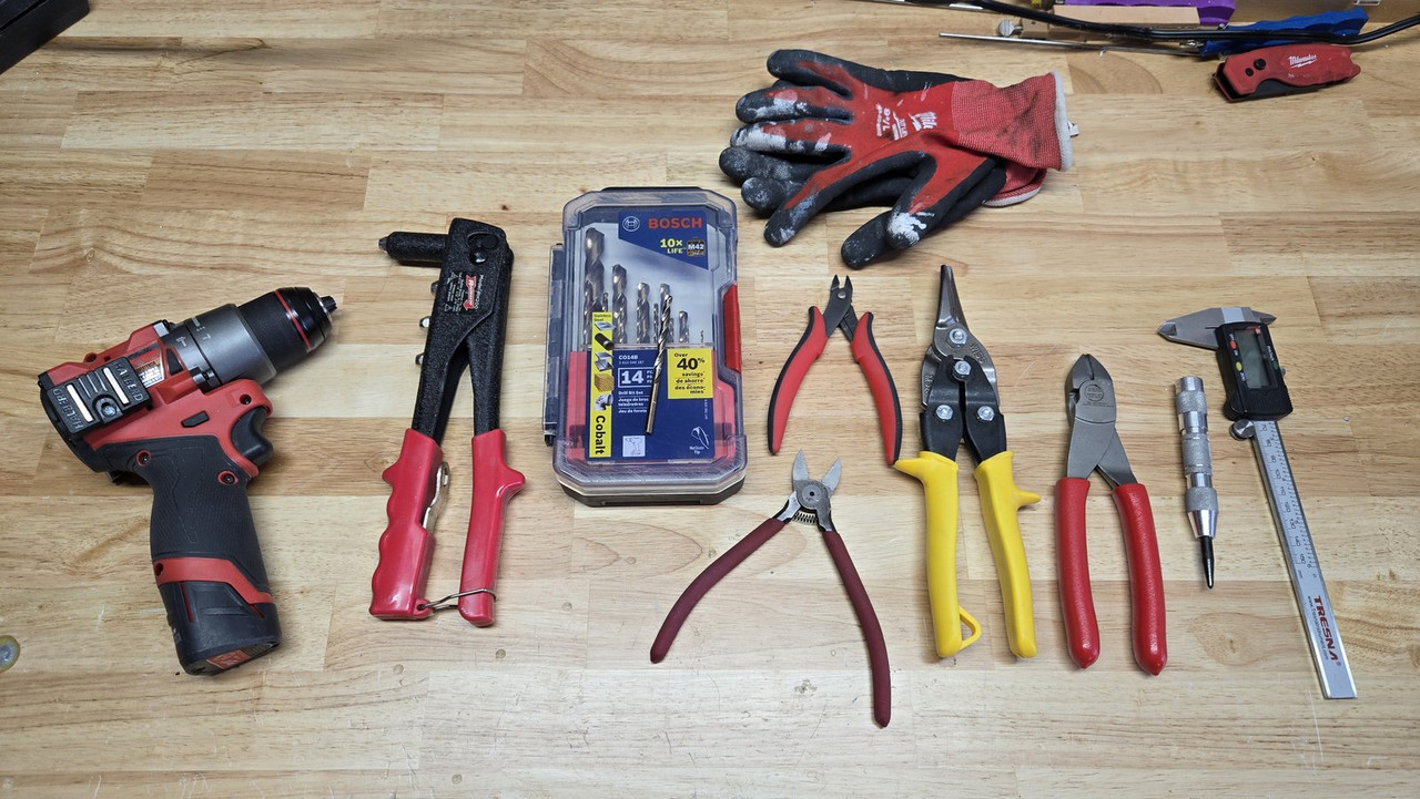

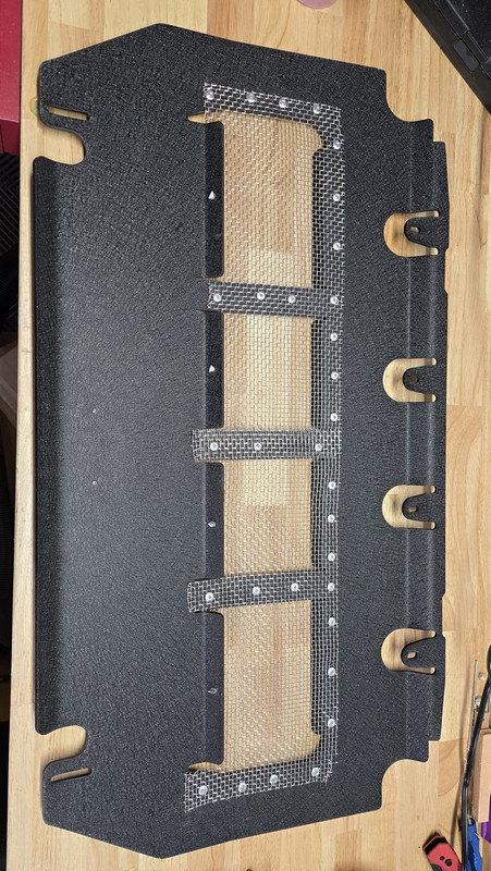

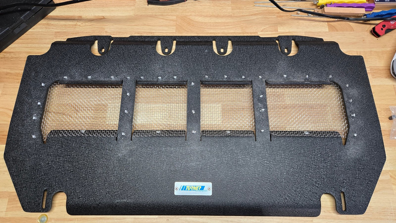

Skid Plate install and pictures:
Parts:
- SS wire mesh (5 mesh density)
- 3/16" x 3/8" Aluminum pop rivets (I used the wrong size)
- 3/8" SS Washers for spacing the aft plate away at the bolts
If using the wire mesh, its probably important to terminate the wire ends as seen in my picture
I used 3/16dia 1/2" long normal head aluminum rivets, its worked fine but I do not suggest using 1/2" length as I was forced to trim and round every single rivet.
All the tools I used. MUST WEAR GLOVES haha

Updated my suspension plan above. Install this weekend assuming no surprise shipping delays.

Originally Posted by Mech Spec View Post
Weekend coming in hot!
I looked this up and didn’t see an application for M240
      04-09-2025, 03:44 PM   #17
Mech Spec
Mech Spec's Avatar
2933
2,365
Drives: '25 M240xi
Join Date: Dec 2012
Location: MA
Same part numbers for g20. 49-305135, just not well updated on the web.
Essentially our entire suspension is shared with the g20.
Are you doing the suspension work yourself, and if so do you have access to a lift or or are you doing it on jack stands?
      04-09-2025, 07:12 PM   #19
Mech Spec
Mech Spec's Avatar
2933
2,365
Drives: '25 M240xi
Join Date: Dec 2012
Location: MA
Yes DIY. FCP euro has posted full guide videos for the g20.
I should say, I'm pretty experienced at wrenching and have a ton of tools, so it's not like I decided to do this out of the blue.
Jack stands. Nothing about this job particularly necessitates a lift.
