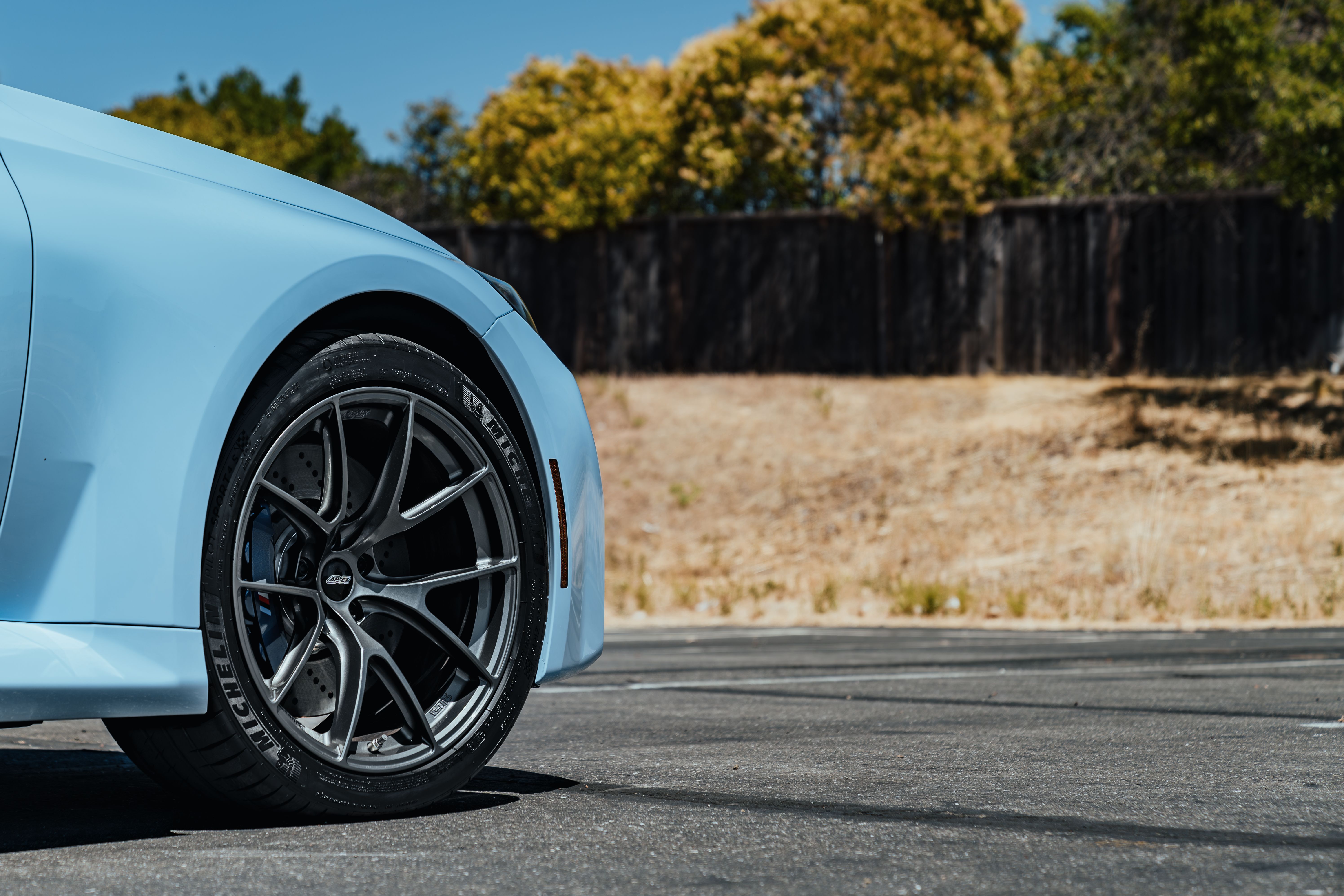

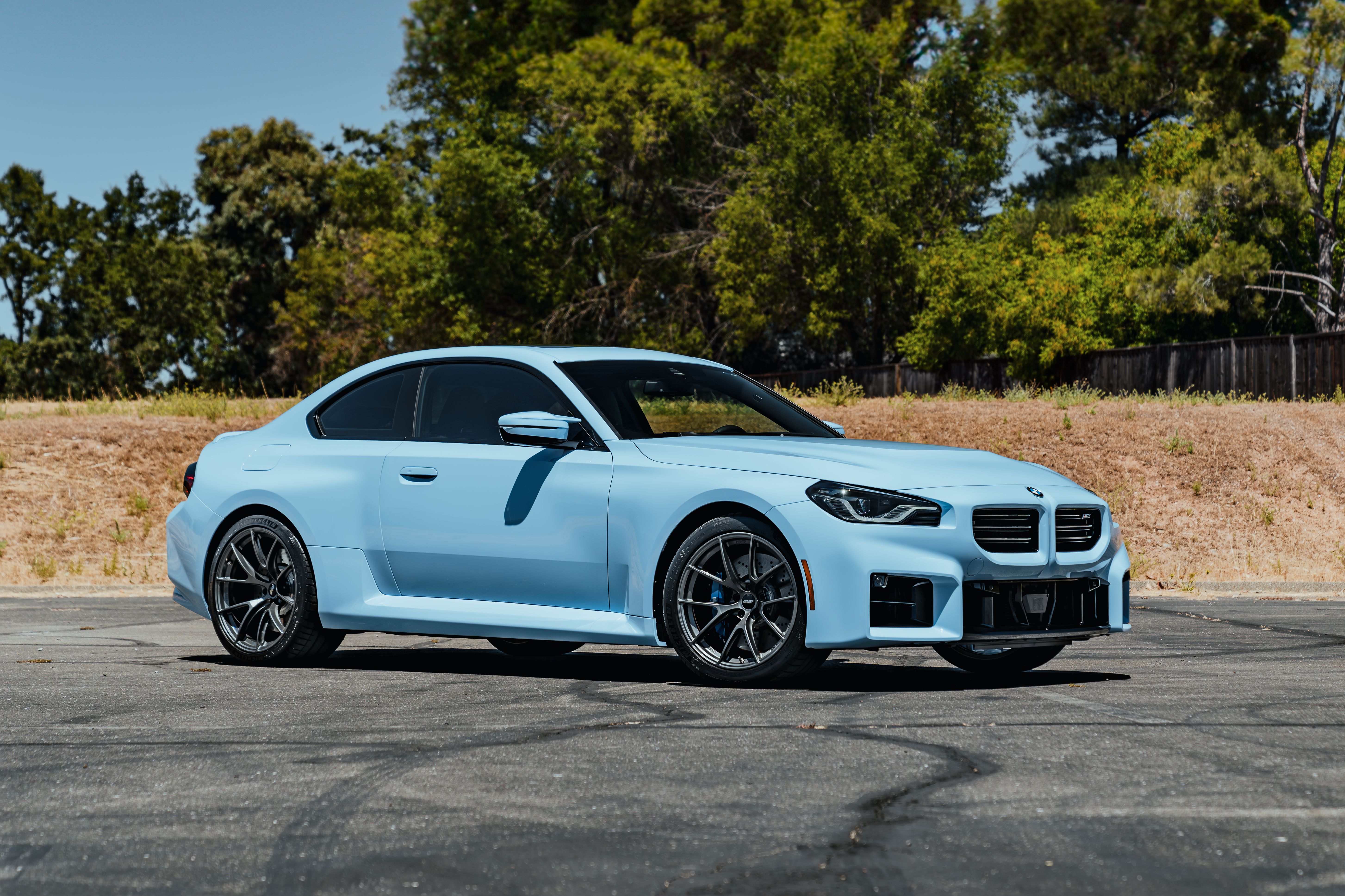

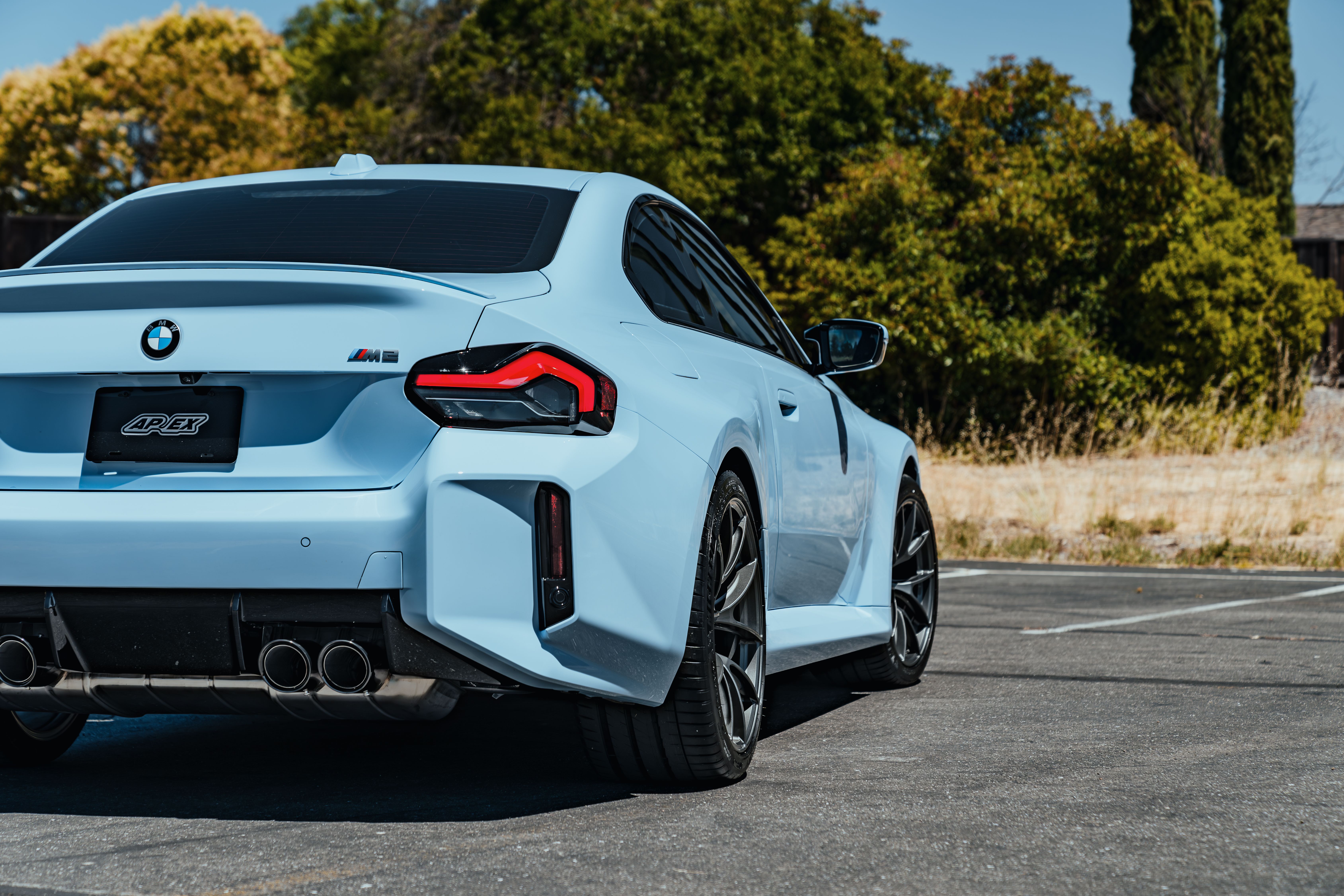

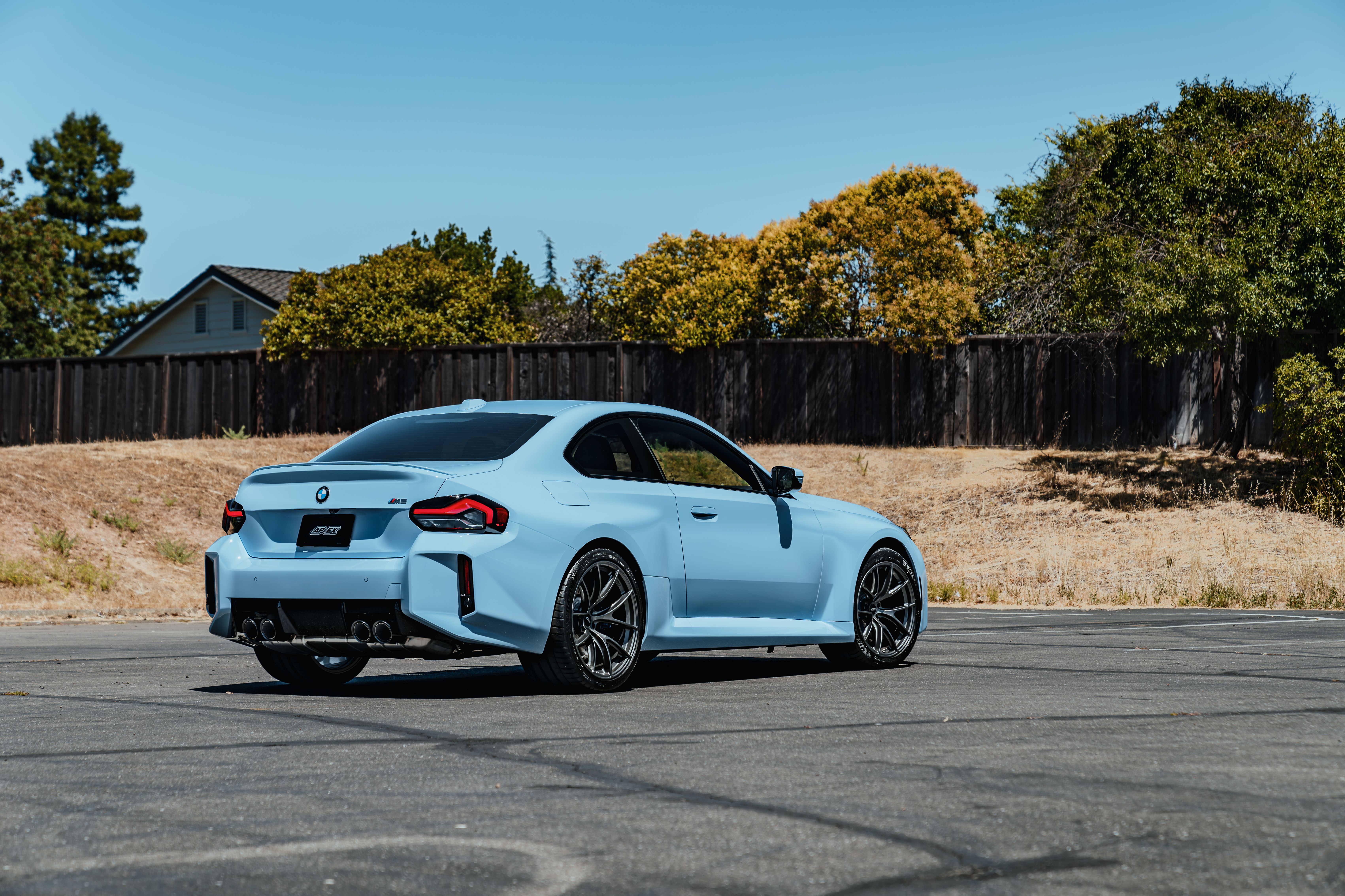

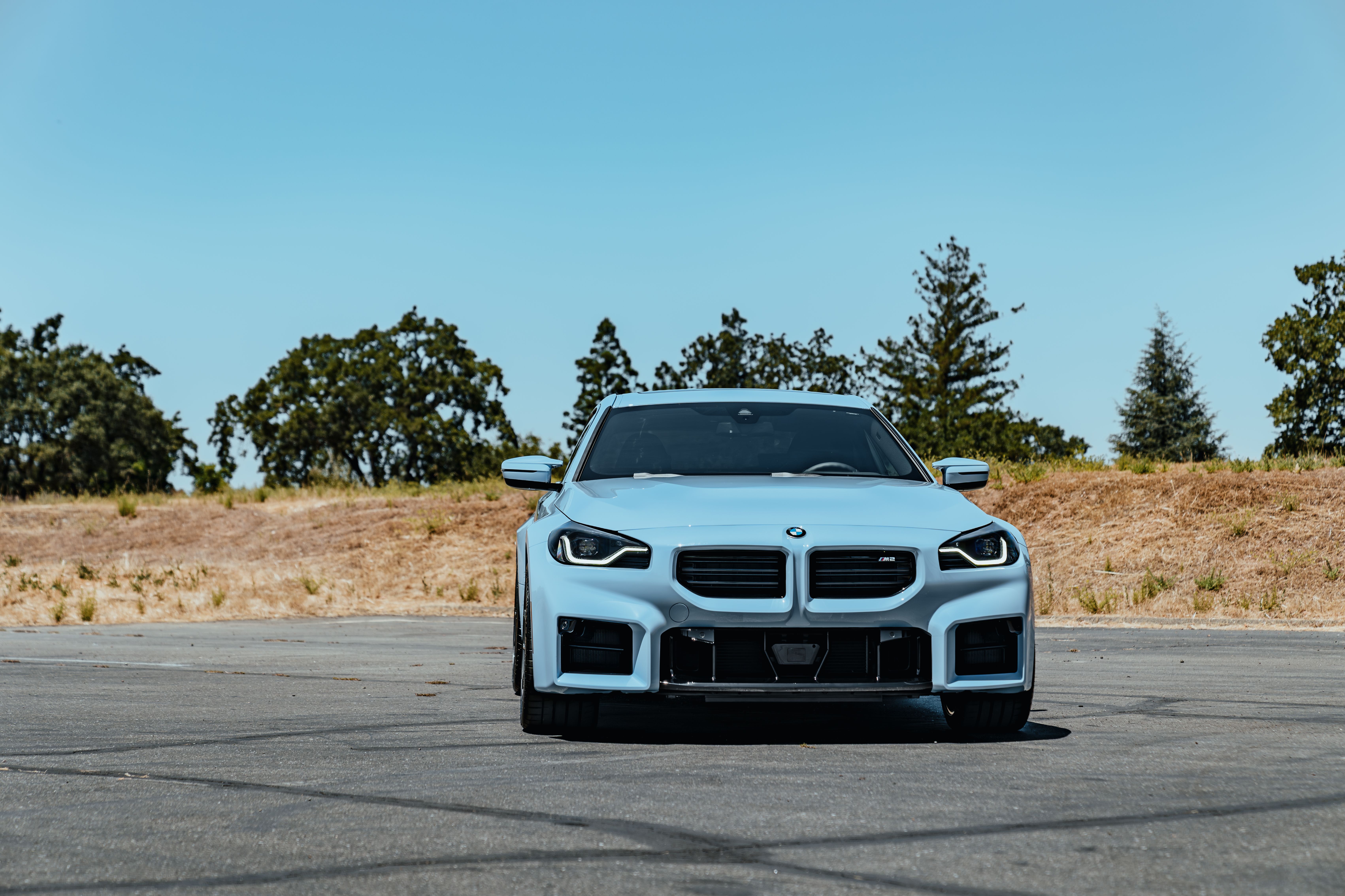

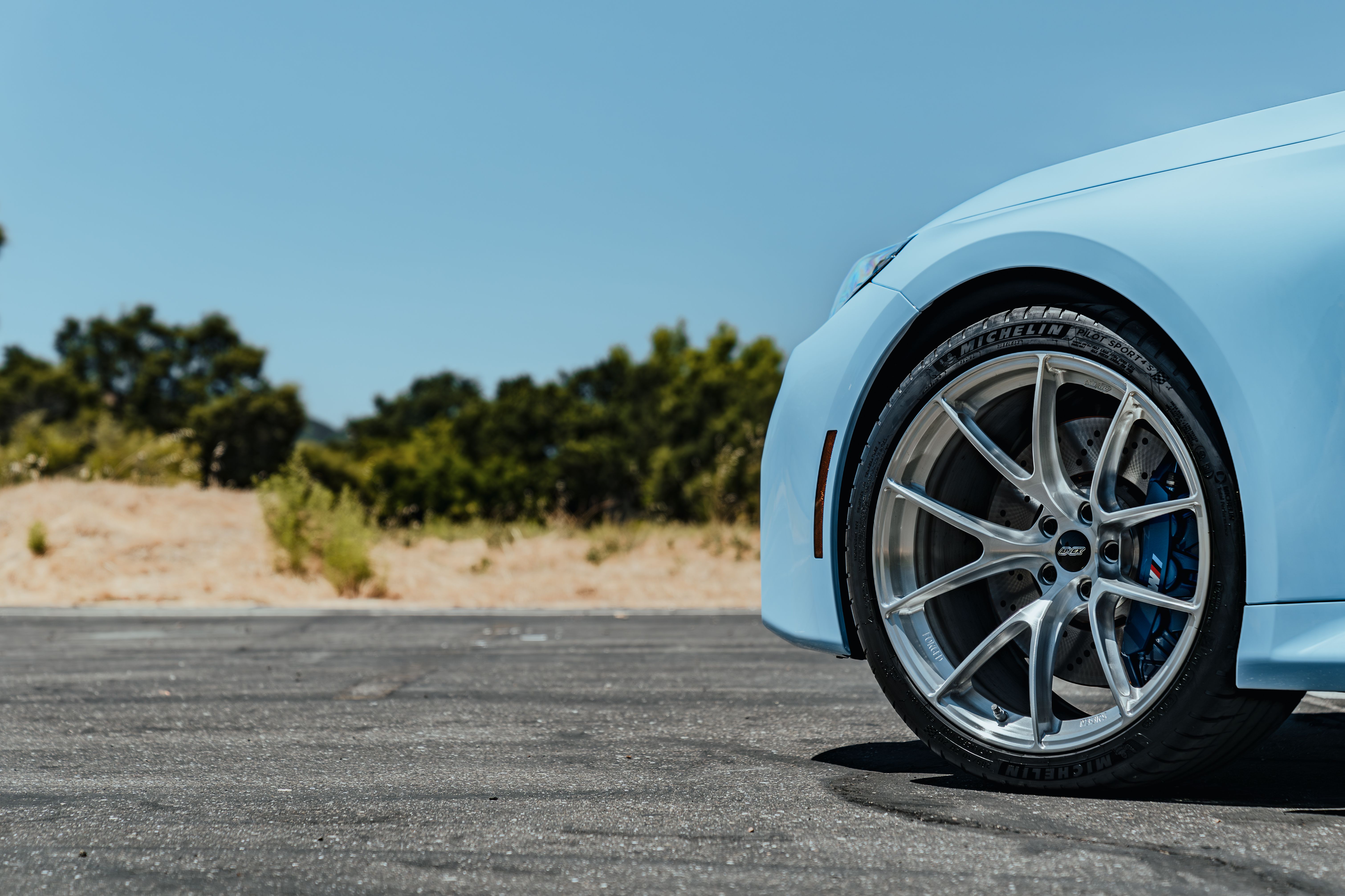

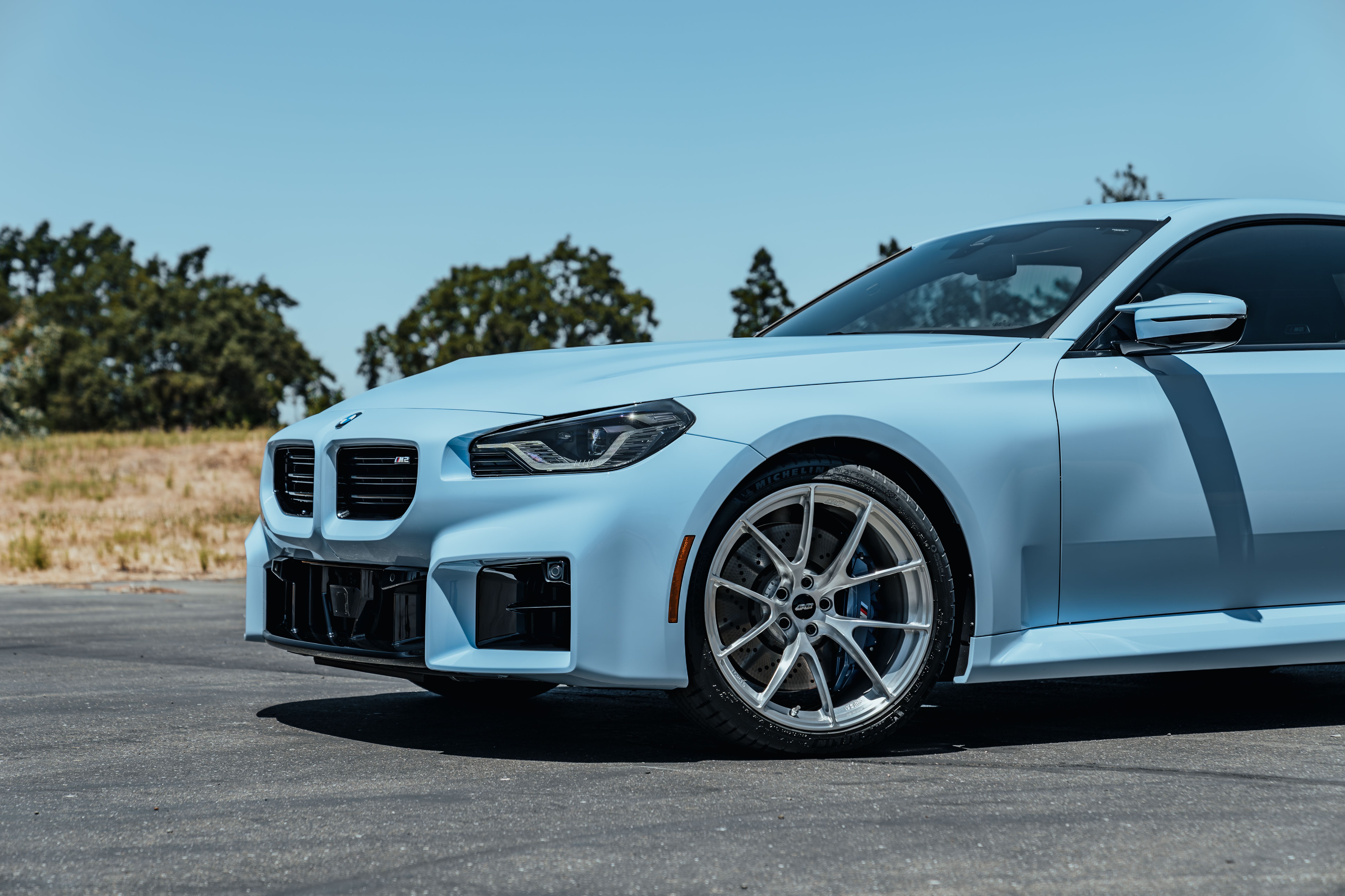

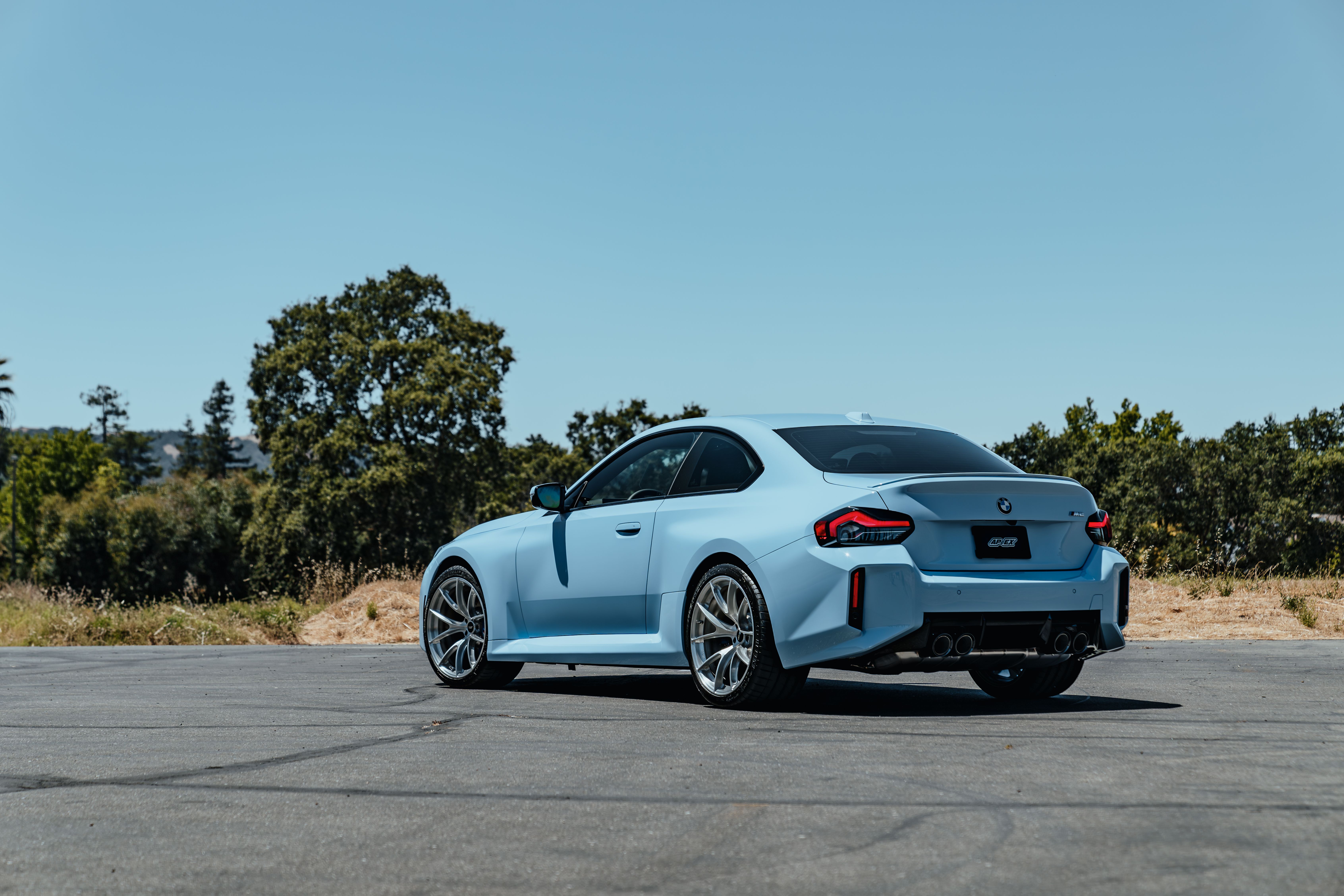

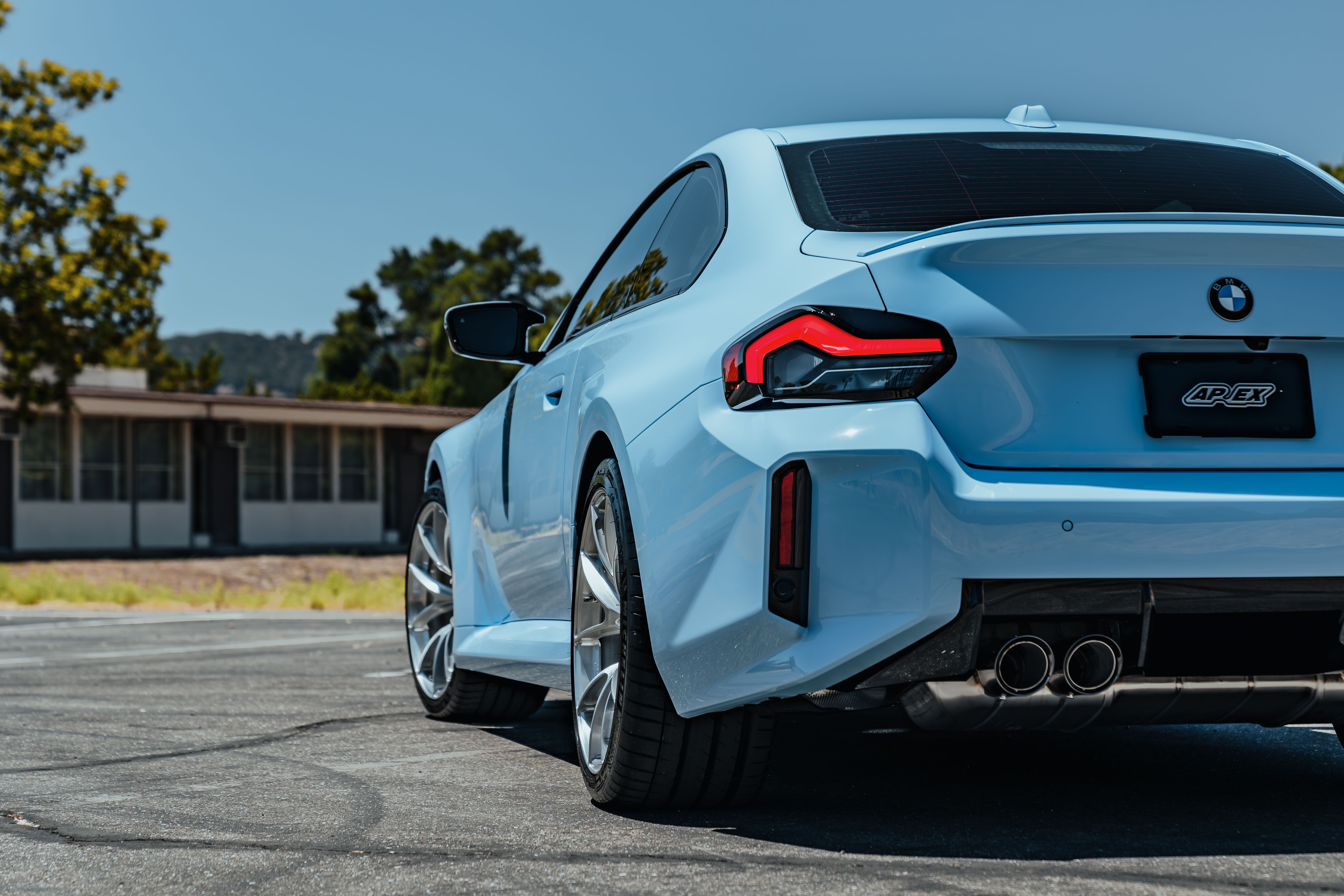

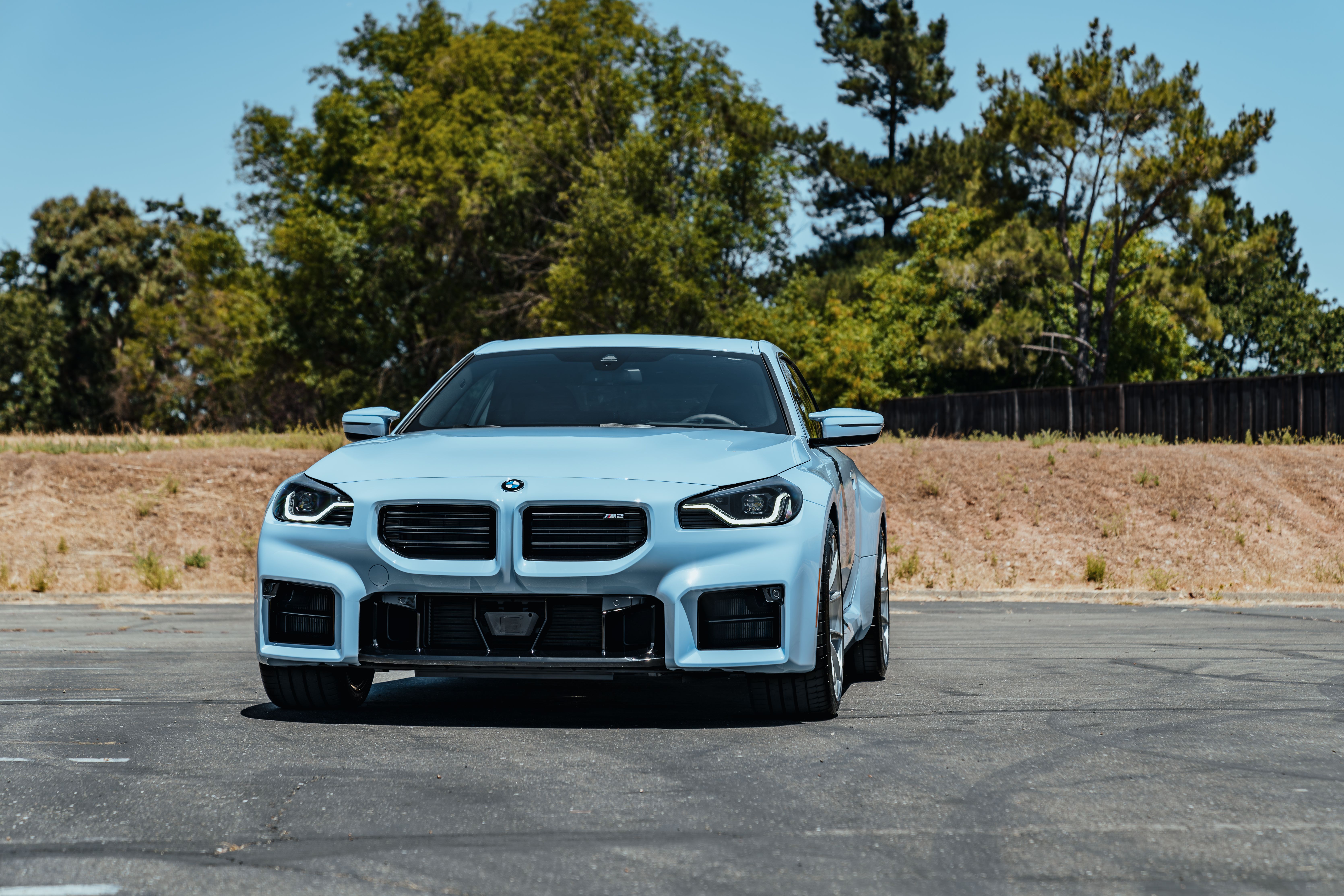

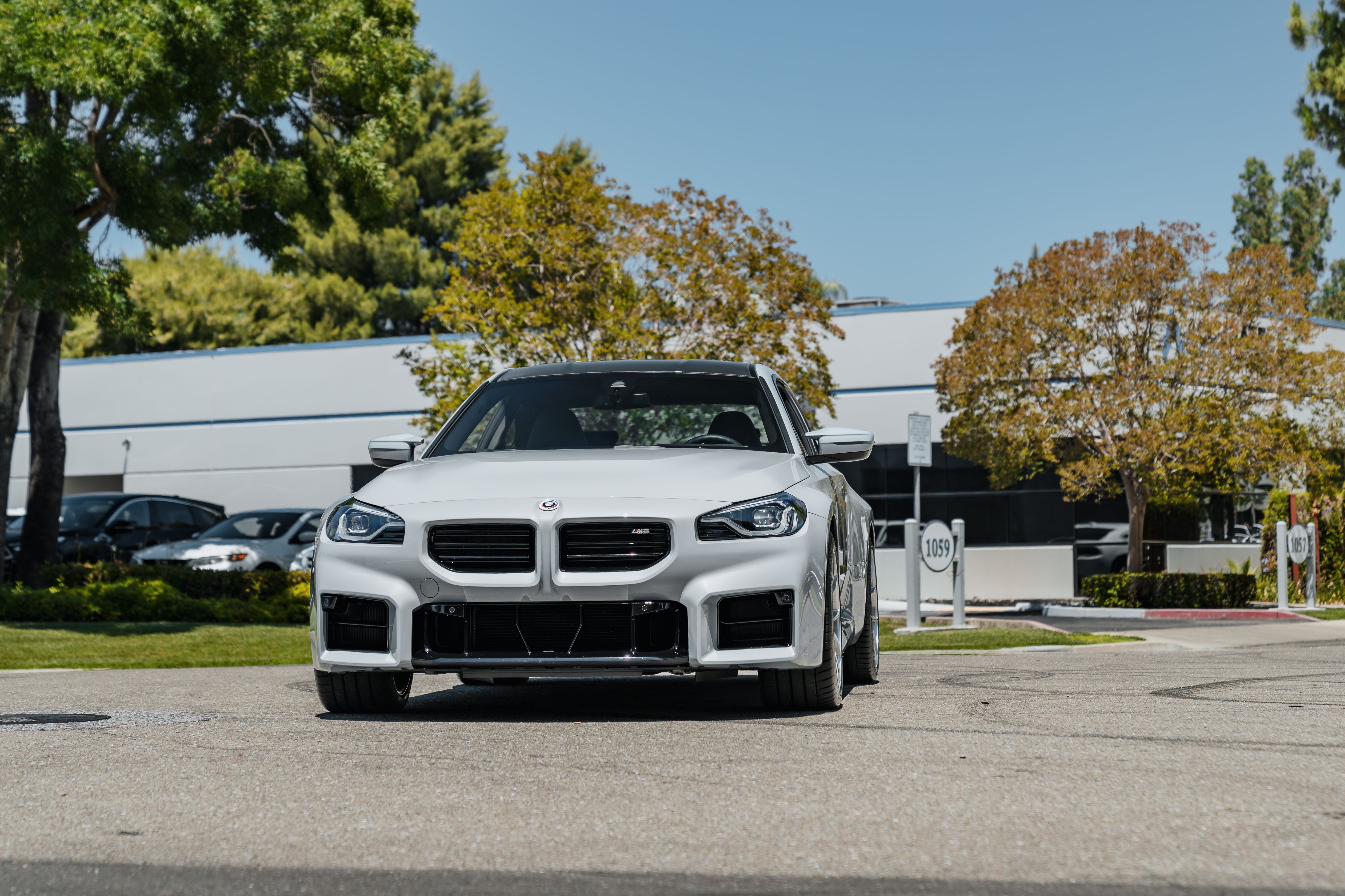

G87 M2 Media
A closer look at our wheels on the G87 M2.
Wheels & Tires:
Anthracite VS-5RS
Front & Rear: 18x10.5" ET18
Tires: 305/35-18 Nitto NT01s
Modifications:
5mm spacers front and rear. Front spacers are required for strut clearance with OE suspension. Rear spacers only used for aesthetics
Full Gallery Available Here

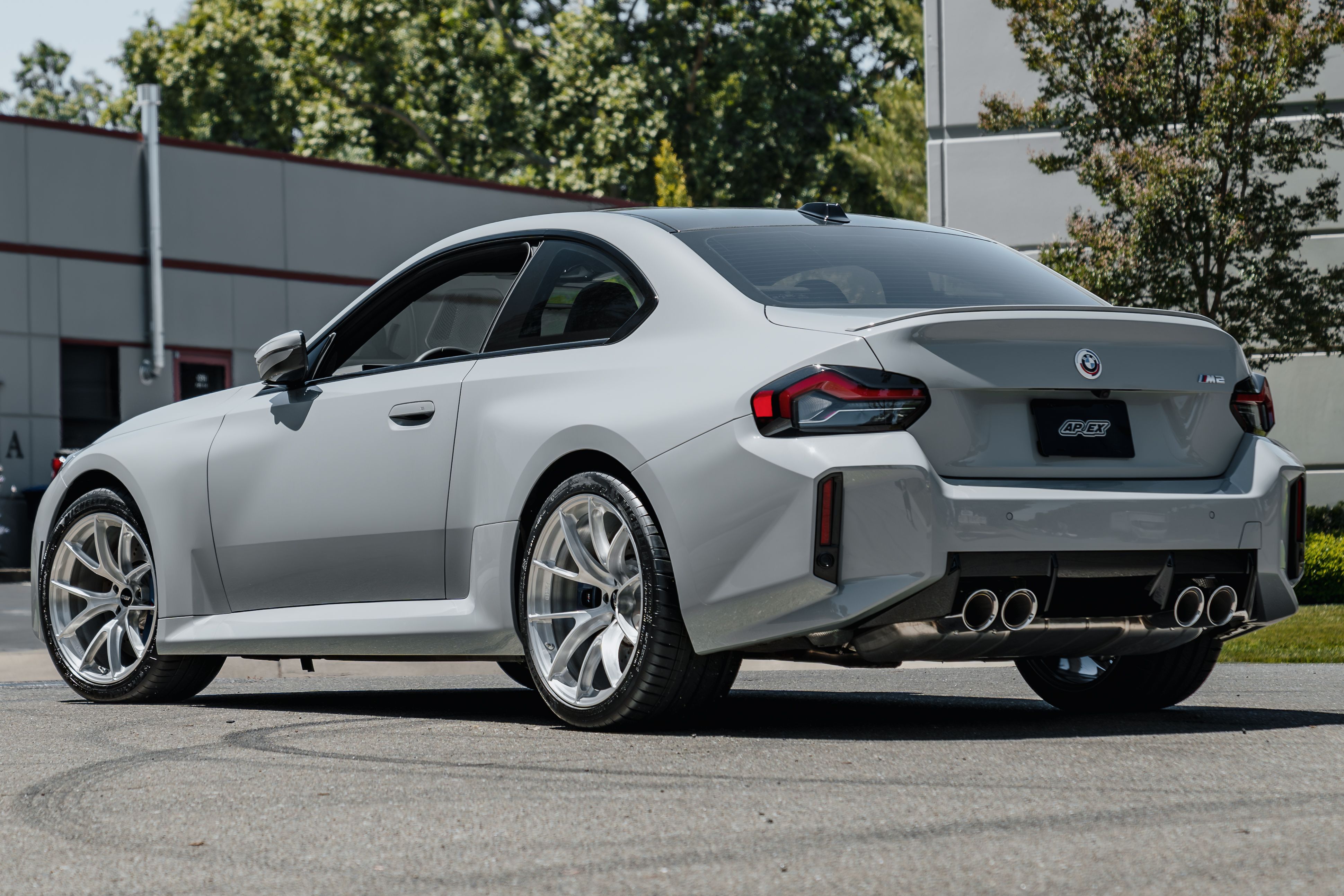

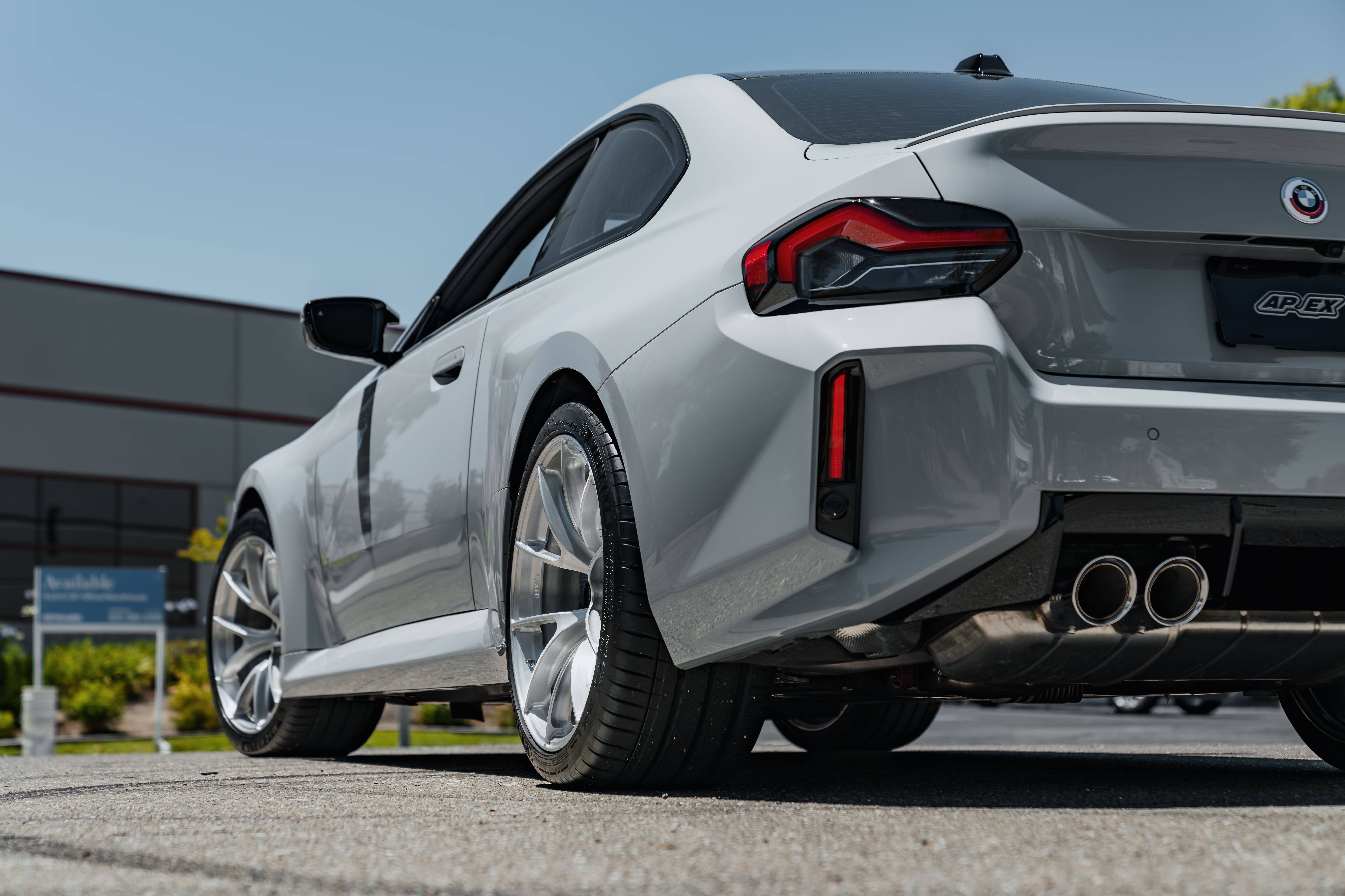

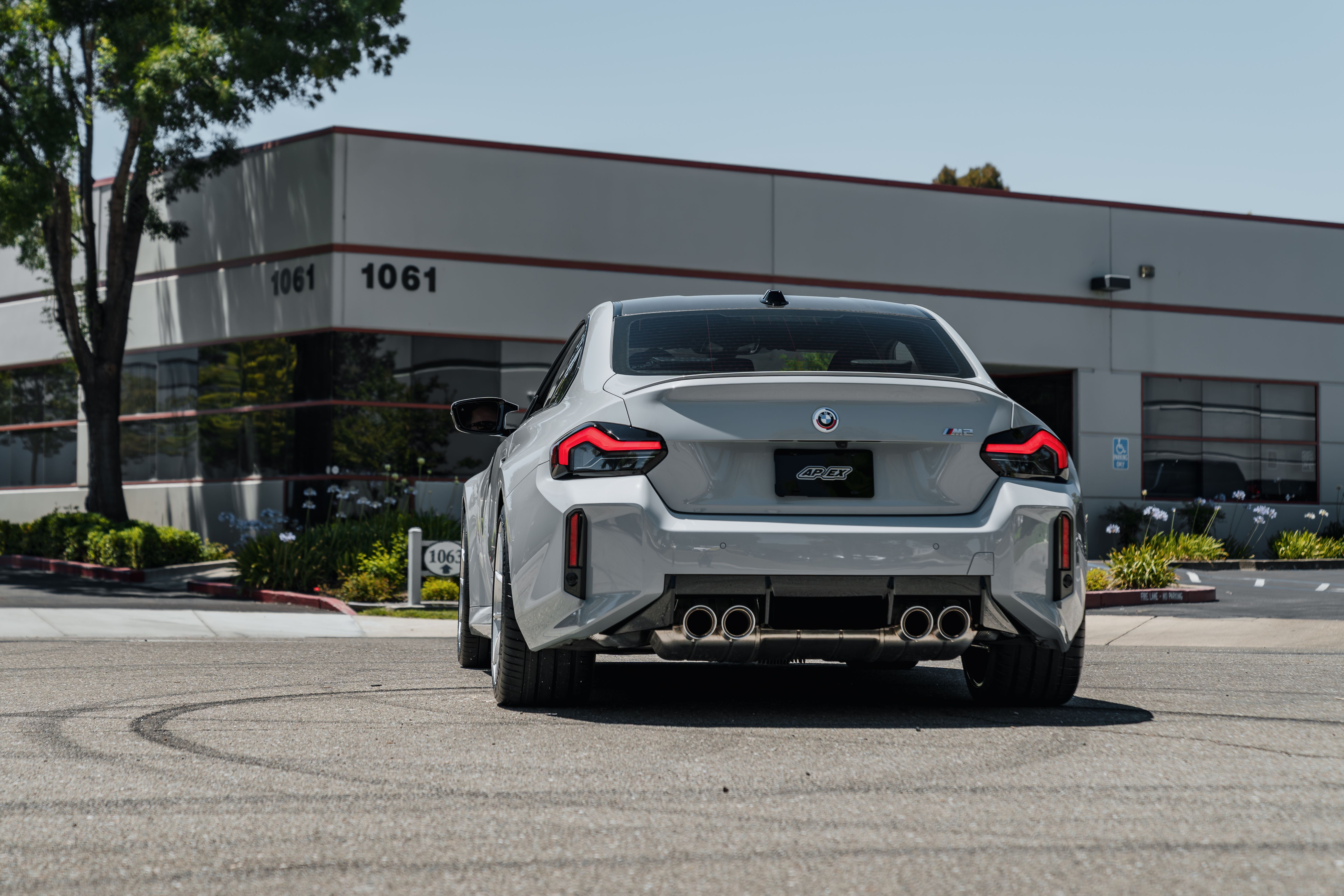

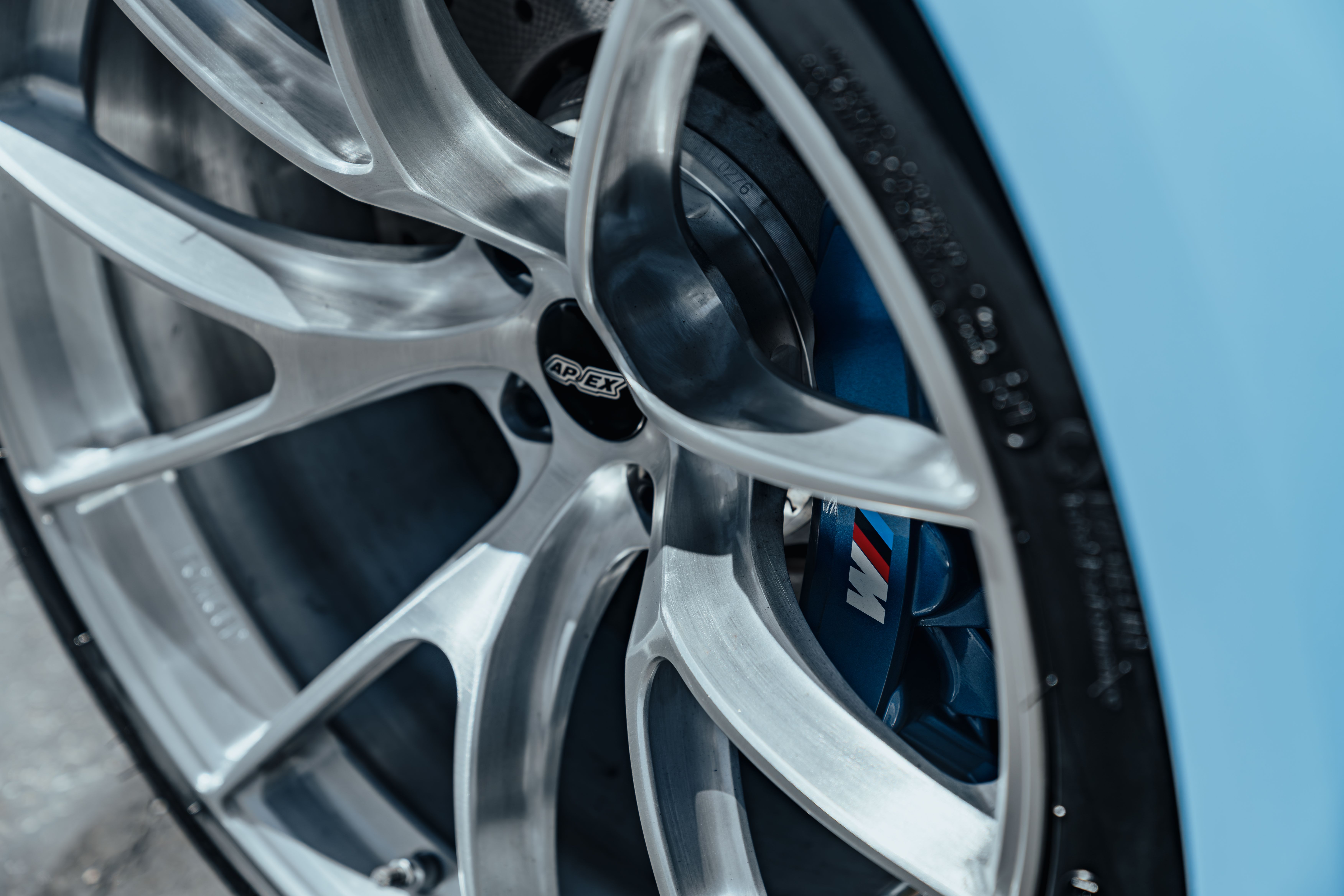

Wheels & Tires:
Brushed Clear VS-5RS
Front: 19x10” ET12
Rear: 19x11" ET22
Tires:
Front: 285/35-19
Rear: 295/35-19

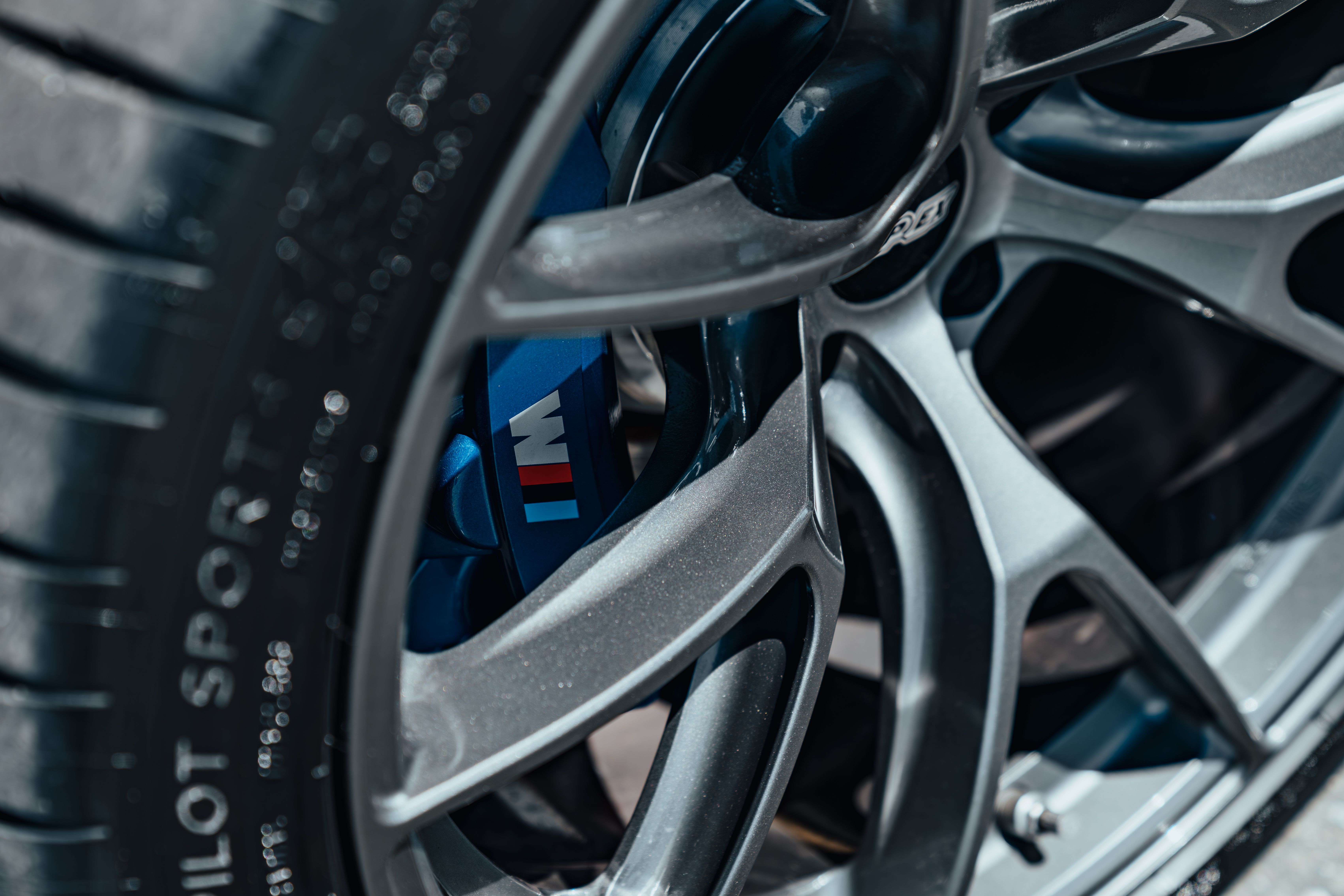

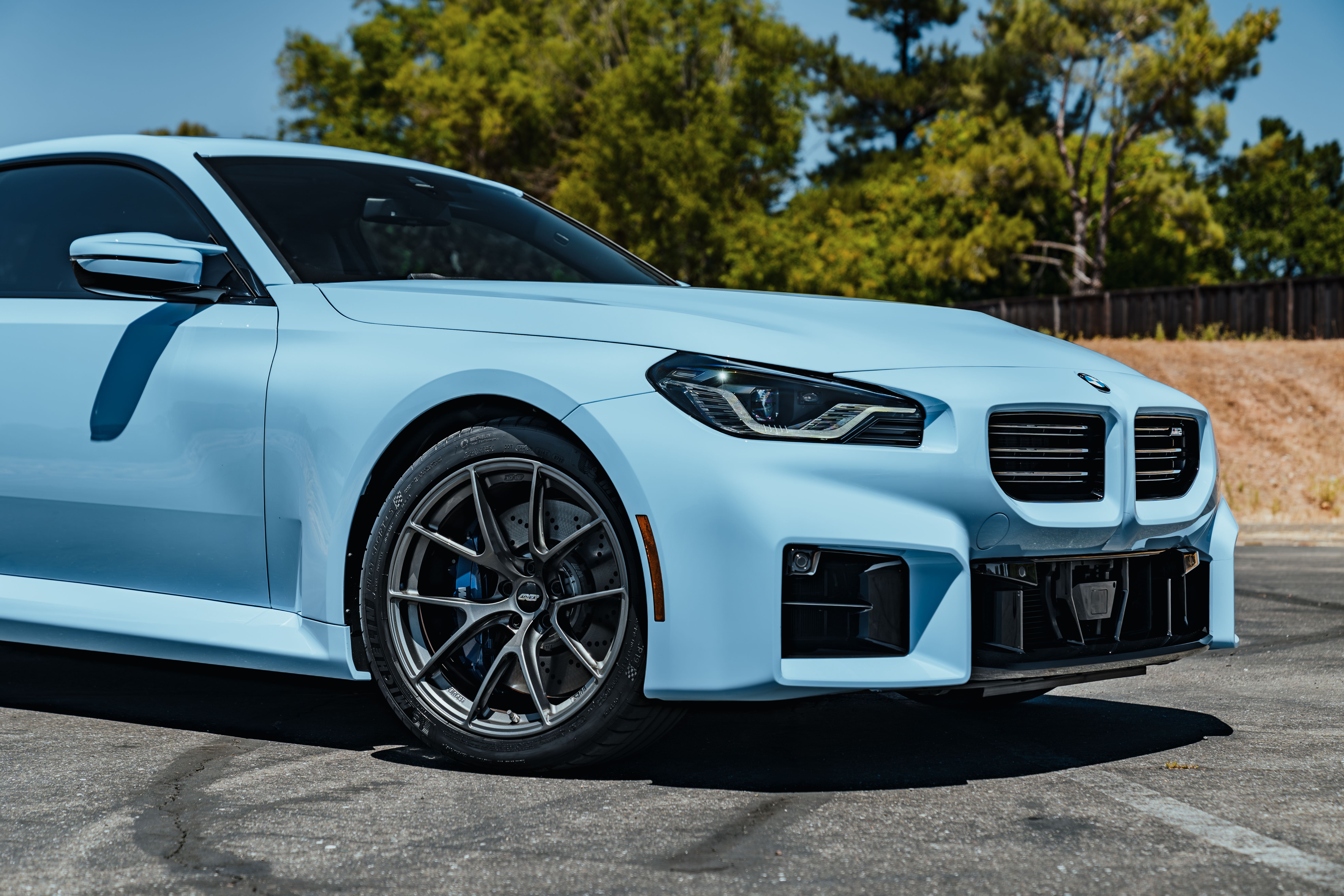

Wheels & Tires:
Anthracite VS-5RS
Front: 19x10” ET12
Rear: 20x11" ET18
Tires: Michelin PS4S
Front: 285/35-19
Rear: 305/30-20

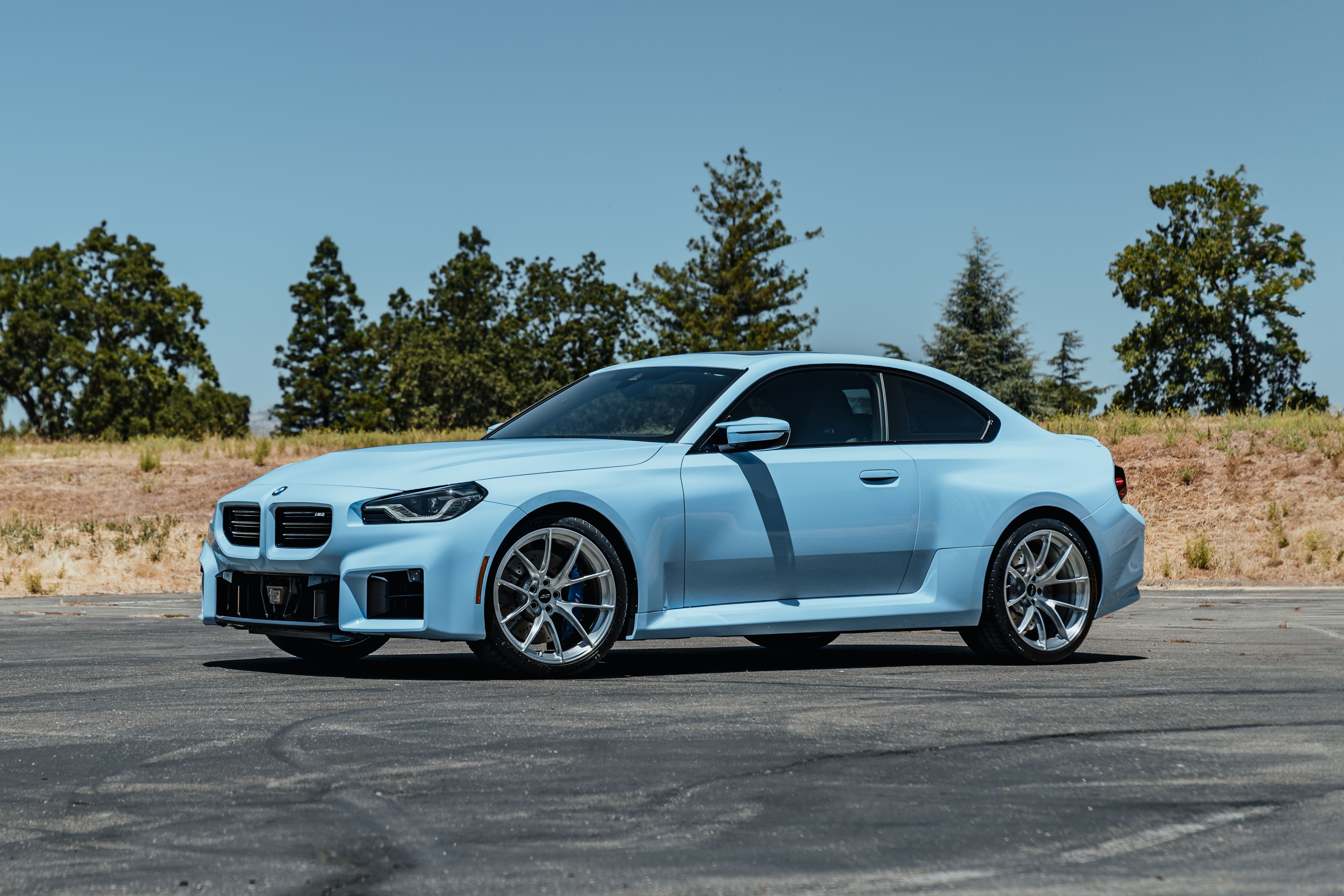

Wheels & Tires:
Front: 19x10” ET12
Rear: 20x11" ET18
Front: 285/35-19
Rear: 305/30-20
